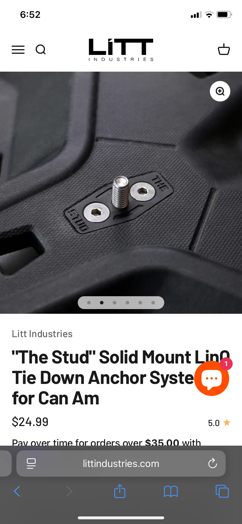

Would this help to mount a Ram mount to?

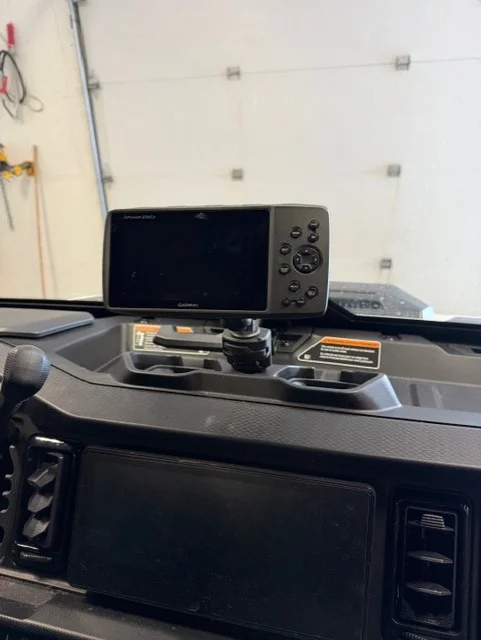

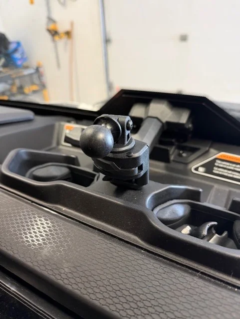

Here’s my solution, if it can help you. I’m using the Linq Lite Action Camera Holder (295101139) with the RAM Mount Universal Camera Adapter (RAP-B-202U-GOP1). It’s solid enough to support my Garmin 276cx.
